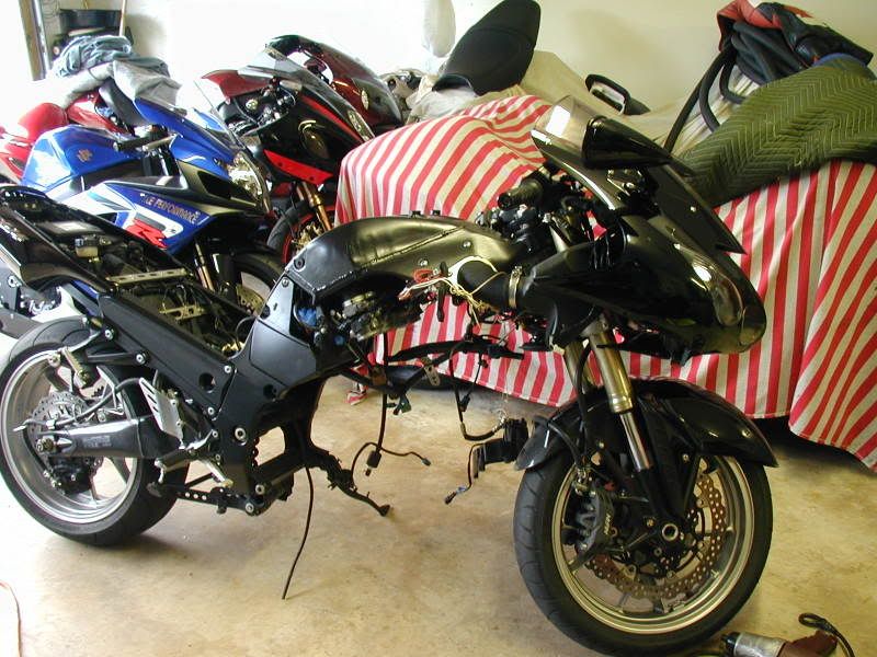

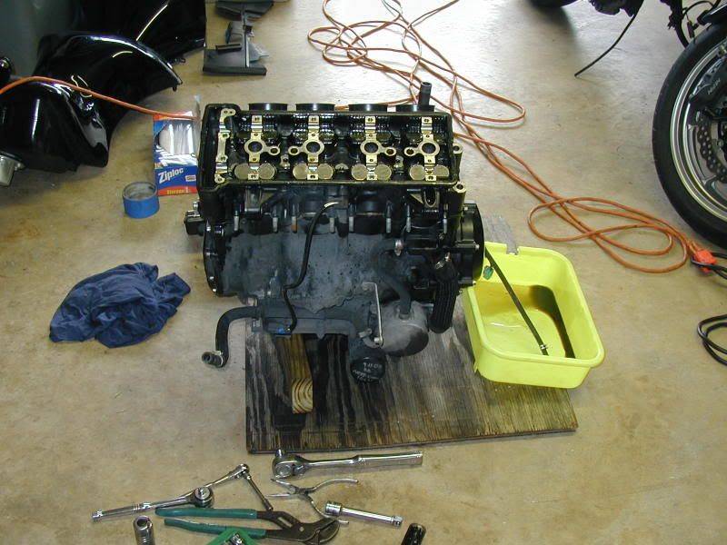

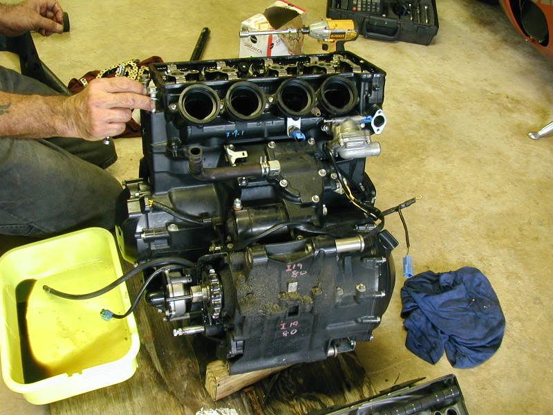

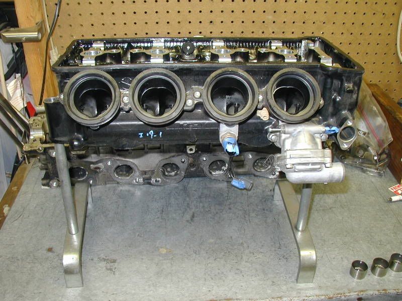

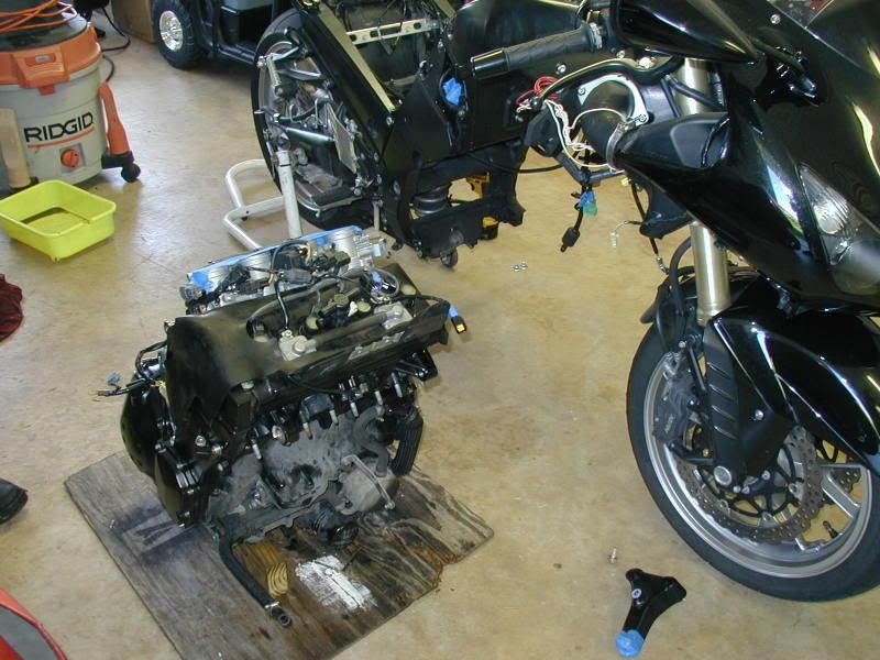

ACE PERFORMANCE ZX14 Project Bike

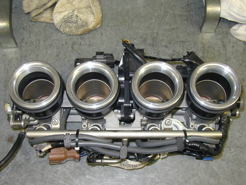

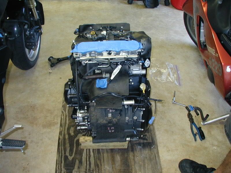

Ace Performance is doing a stage 1 Kawasaki Zx14
our goal is to go over 200 MPH at Maxton or Texas mile N.A.
We just droped the motor today and looks like there is some good MPH to be gained
actually I think in the area of 12 MPH
This bike will be faster all around and will pull much harder thru the gears
and not so lazy in the upper gears.
Here are some pics of our project bike.
There will be more to come by the end of the week

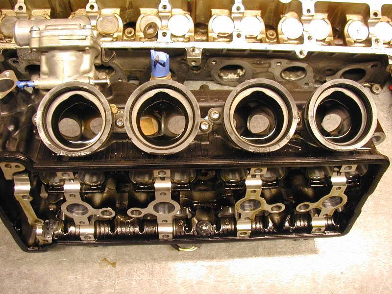

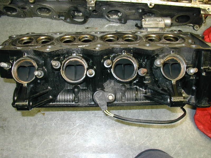

I will be porting the head this week and waiting on parts so we should have it
ready to tune next weekend.
Sal.

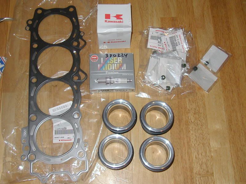

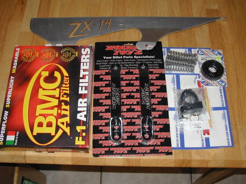

I am waiting on OEM head gasket, BMC air filter, new chain valve seals, velocity stacks,
and cam sprockets to degree his stock cams.
This bike is his daily driver so we are doing a very streetable setup only bumping
compression a 1/2 point wich should be milled only 0.007" also removing butterflys.
I looked at the head and needs attention starting right at the boots all the way down to
the bowls.
I will take some measurements figure in motor size and were this bikes RPM's are
going to be at and then do my thing.
Finish it up with a REAL WORLD TUNE.
Sal.
Sal.

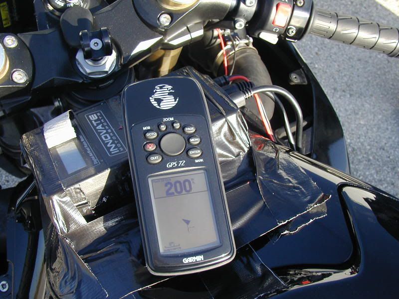

What is that kit you have showing in the second photo?Looks like a meter and pieces in a foam box.

aliveagain
That is a calculator
