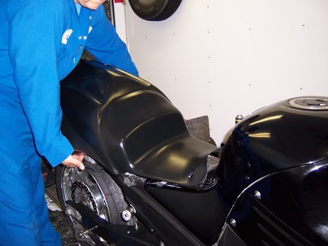

As promised, here's some pics of the installation of the Factory Pro 'Race' Velocity Stacks.

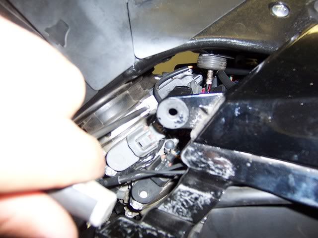

Installation was quite easy. I took longer than normal, just because this was my first time ever doing this and I wanted to make sure I didn't miss anything.

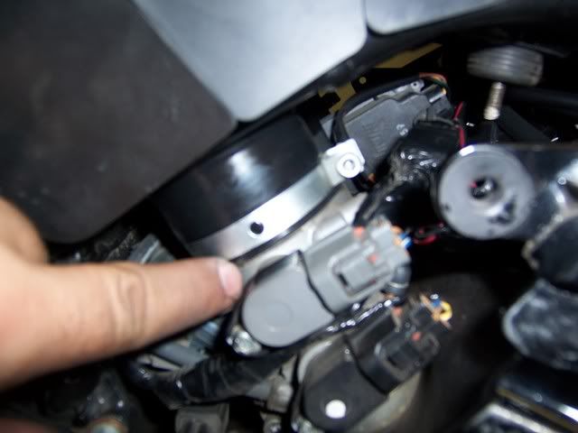

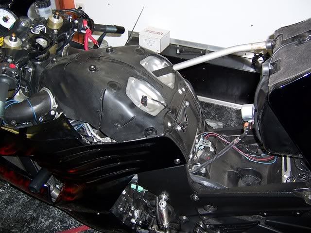

I removed the plastics, and propped up the gas tank. Would have been easier to remove the tank, but I'm lazy.

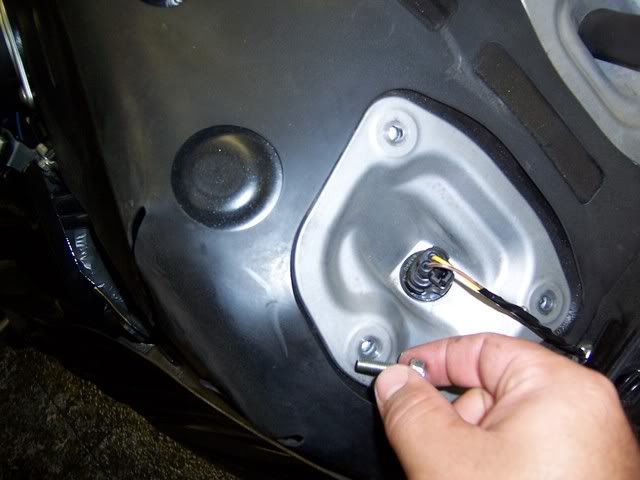

Next I removed the air box covers.

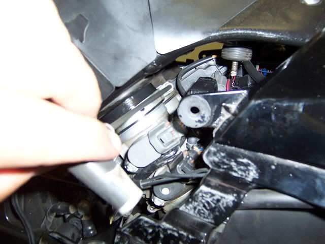

Then I loosened the clamp holding the stock stack to the throttle body. I did one at a time starting from the right hand side.

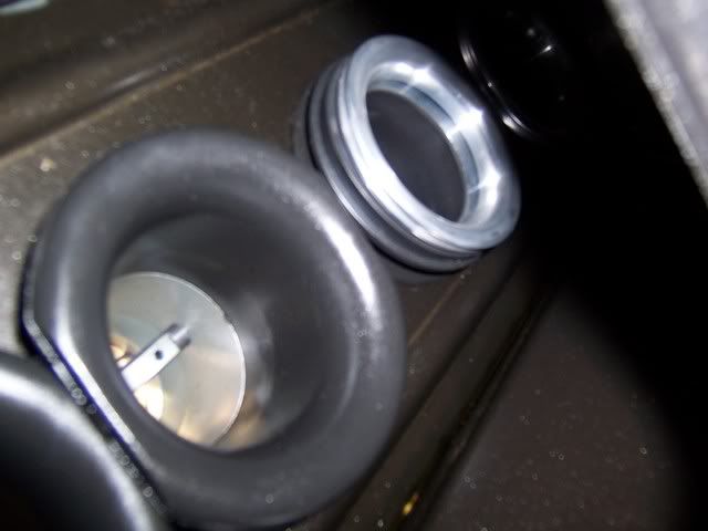

After loosening the clamp, I pulled the stock stack out from inside the air box. Here you can see the differences between the stock stack and the race stack.
I then cleaned out any debris the fell into the throttle body, which was just a little bit of dust.

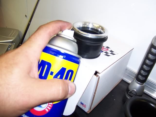

As suggested by Ryan Schnitz, I sprayed the rubber part of the new stack with some WD-40 to help it slide through the frame seal, frame, and onto the throttle body.
Fit was perfect!!

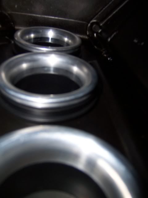

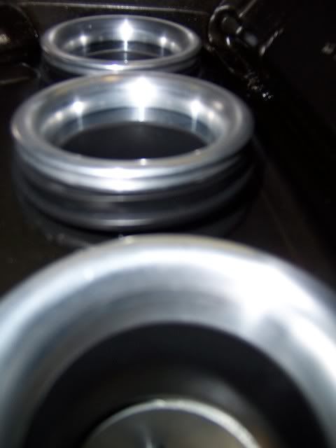

I then moved on to the remaining 3...
Here they are fully installed...

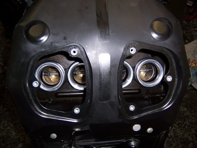

After making sure everything was secure and my air box was clean, I re-installed the covers..

Plastics went back on and then finally it was time to put the seat/tail back on...

Boy do I feel like a dumbass. I had a feeling that something just wasn't right after the installation. Retarded as it may sound, I had kept the stock seals in place. No wonder the stacks didn't push all the way onto the throttlebodies. DOH!!!!!
Just got back from tearing it all apart again and doing it the right way. Stock seals DO NOT GET RE-USED!!!! My mistake. There weren't any instructions that came with it so what do I know??? I'm not a mechanic, I just like to go fast.
Anyways, here's the new updated pics of the correct installation. Next Friday we'll get to see if they make a diference.
