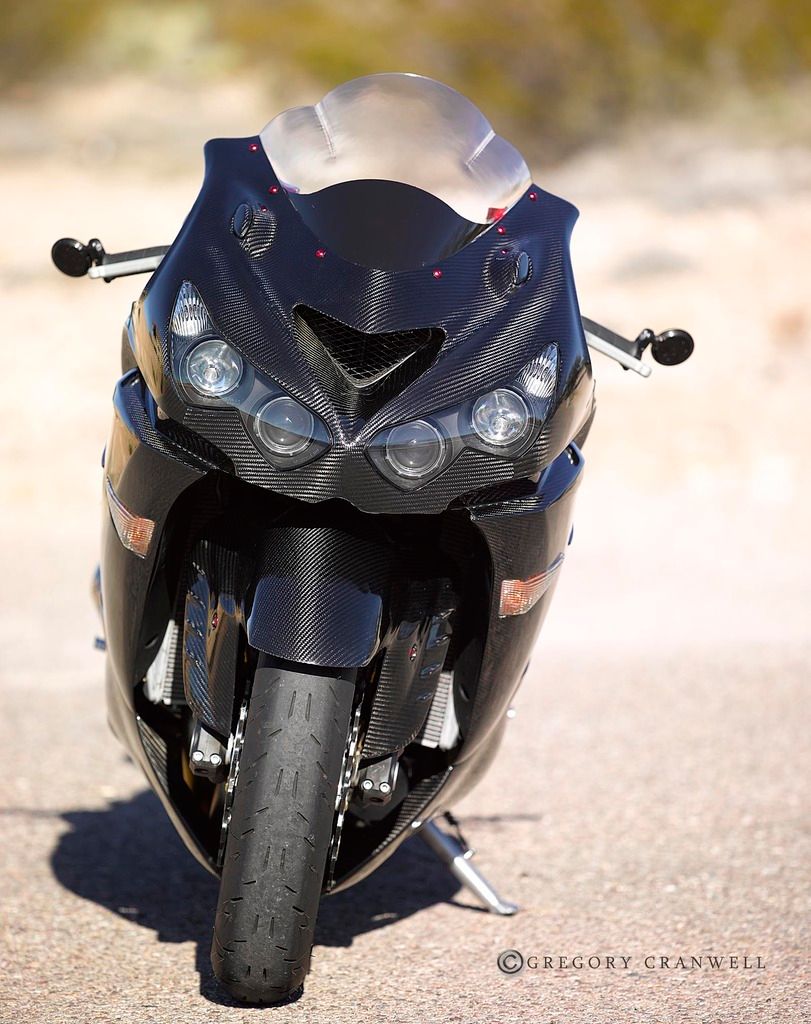

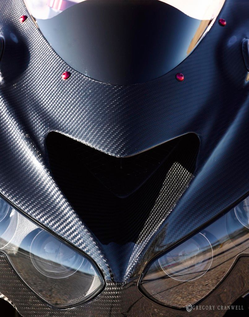

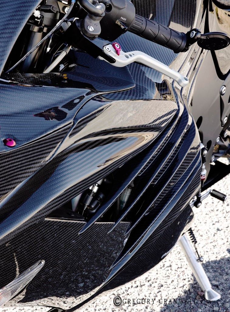

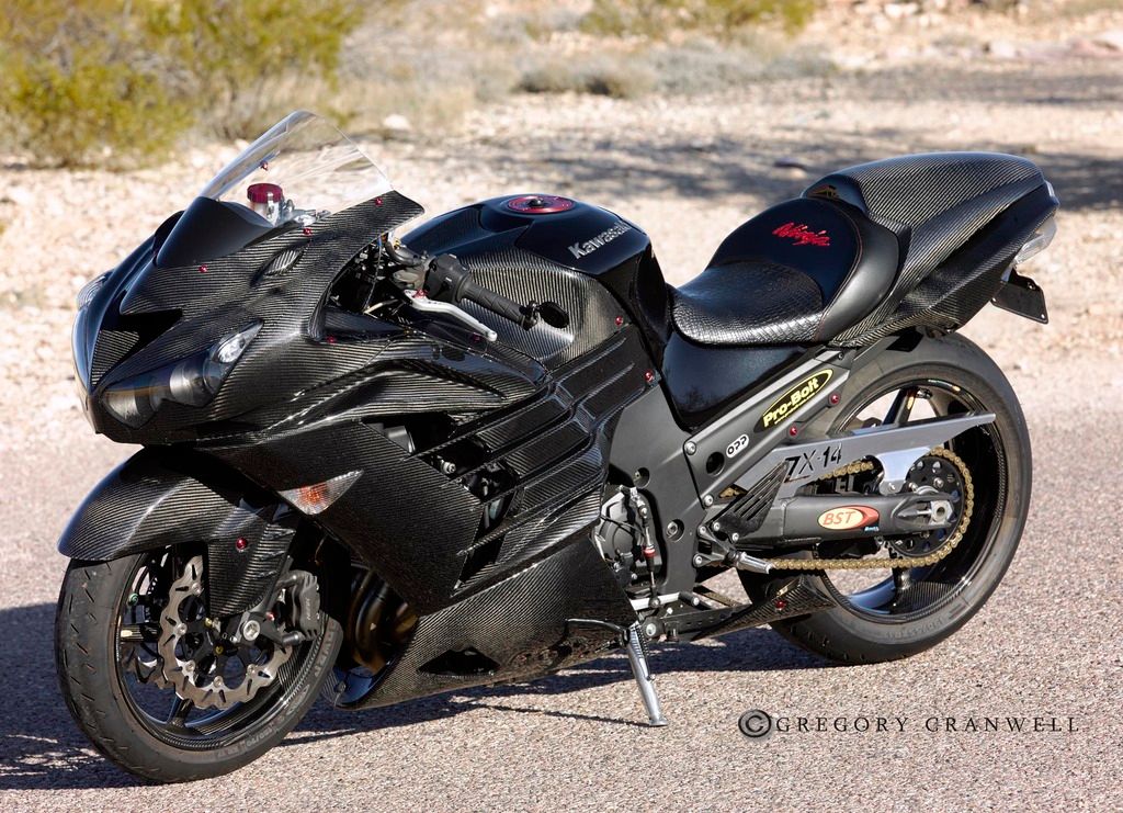

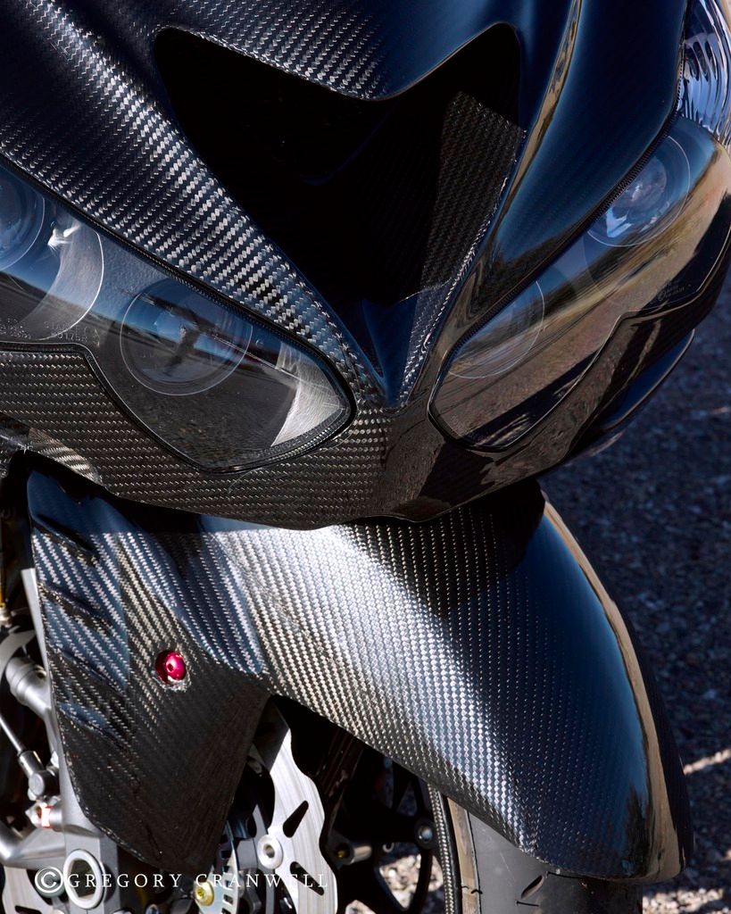

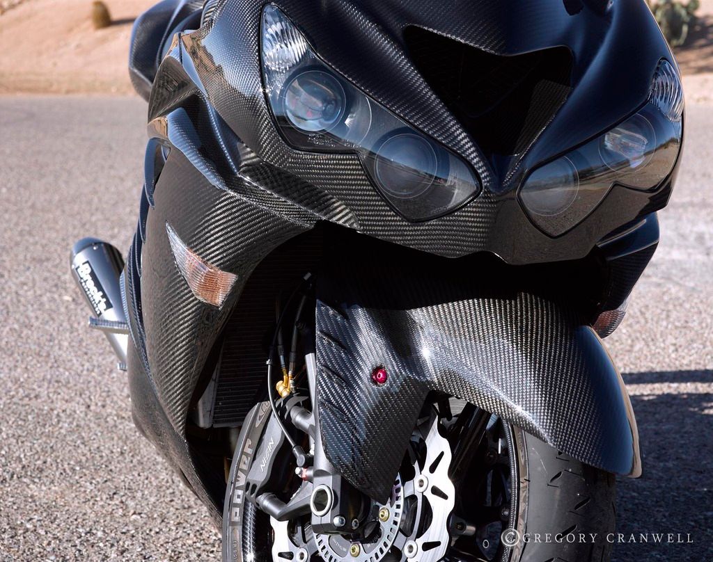

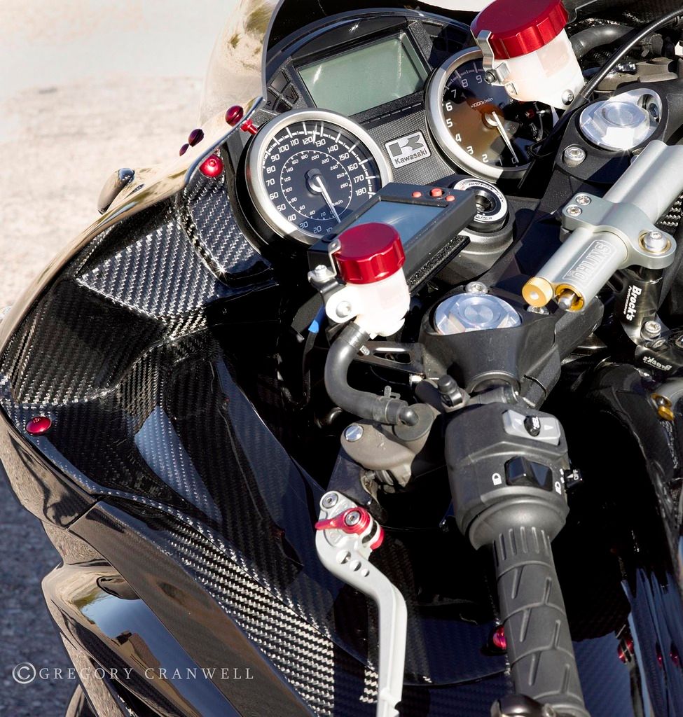

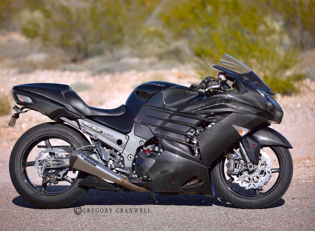

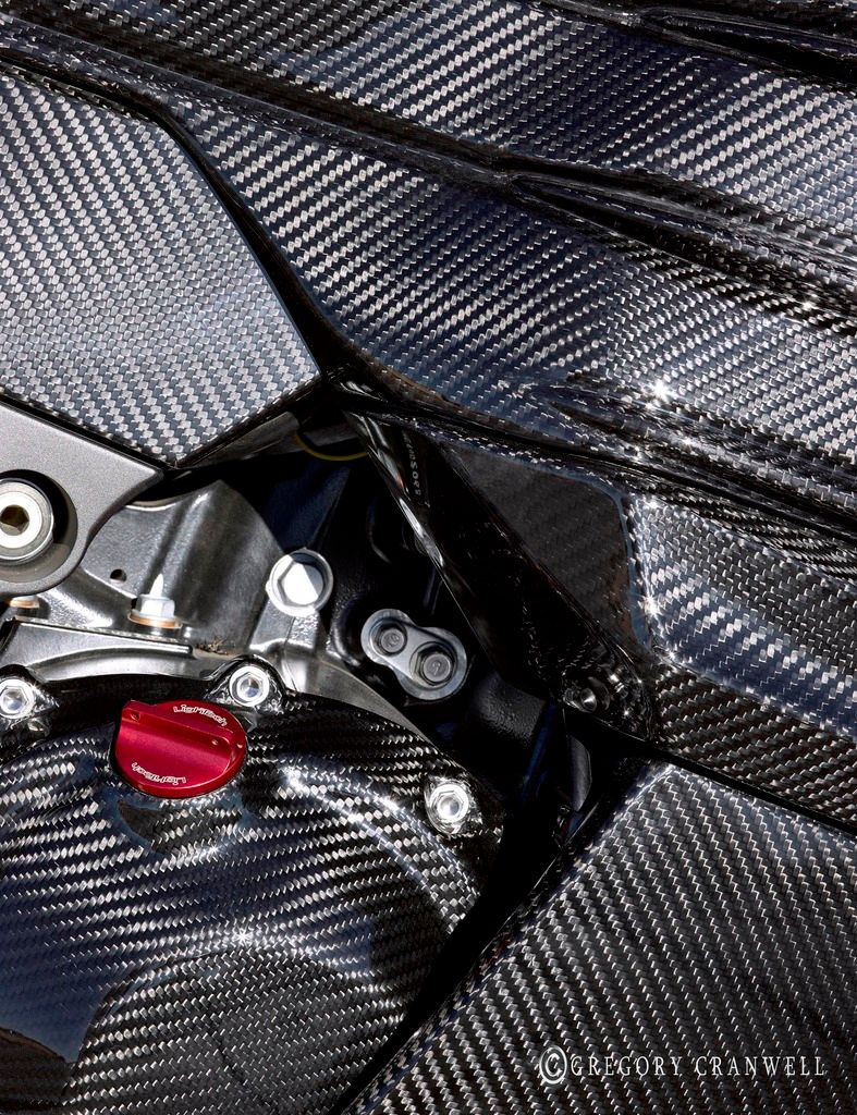

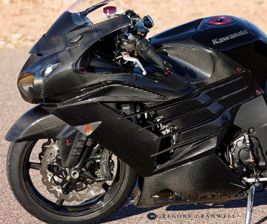

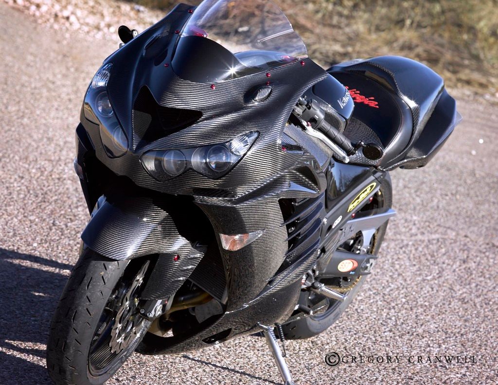

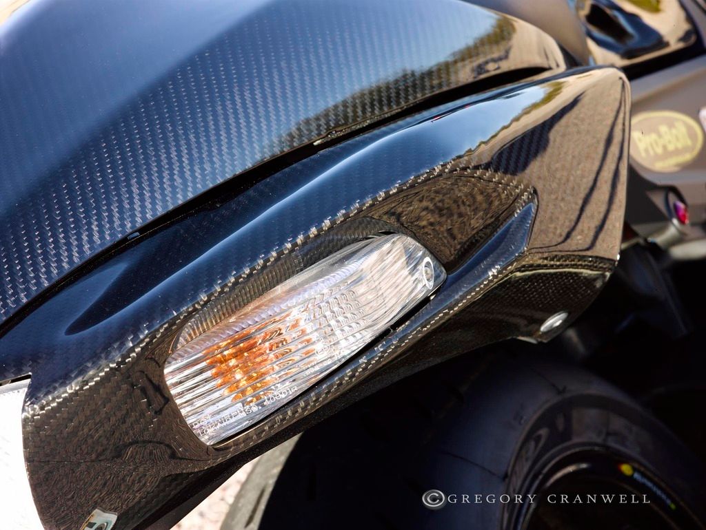

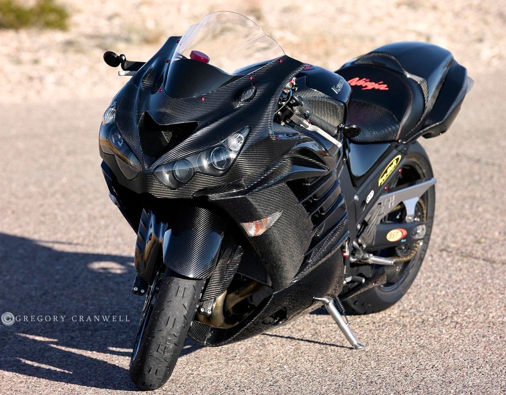

So I have been working on a project to make my 2012 ZX-14R all carbon fiber. I have been working with a relatively new company "Motocomposites" who are based in Canada an producing some stunning carbon fiber work. They used my motorcycle as a prototype for a good majority of the pieces and I spent several months test fitting the fairings. It is finished and I left the tank stock but everything else is carbon/fiberglass backed. I can tell you that the pieces weigh almost nothing, stiff as all heck and strong as steel in some regards. Trying to drill holes through this stuff is very impressive. The carbon fiber will smoke and start to wear the drill bit before it is penetrated. Very good stuff!!!! The final finish of the pieces is like glass and the weave is almost artistic in how they patterned the overlay of the fiber in different directions. Very flowing and seamless. Yes, you are talking aftermarket, so you will be widening holes, doing some minor fit modifications as some of the mounting posts don't line up very well, but when you consider you are overlapping three different aftermarket panels with three different holes to line up with one screw post the overall fitment is very close to stock which is hard to do!!!!!! You won't find some of these panels from other dealers because they won't have them in stock!!!! They just have never considered having them made. The front fairing was amazing as to how well everything lined up and how the headlights just dropped into place perfectly and all of the screw posts lined up like oem. The one thing to mention is that most of the screw posts on oem have just plastic holes for the screws to tap into. These actually have metal sleeves for 6mm screws but you will have to get the screws from somewhere like ACE Hardware. But it makes mounting much better as you can torque the panels a little tighter. One thing to note. If you purchase the clutch cover which actually covers the OEM aluminum cover, after you tighten the clutch cover bolts, after a few hundred miles you want to re-tighten them because they will settle in and loosen a slight bit, dripping some oil (no big deal). When you consider the low price vs. value, it really can't be beat. Motocomposites customer service is top notch. I trust them 100% They will return calls promptly, very honest and quick to satisfy.
So how does the bike feel???? Feels much stiffer, way lighter, nimble, and accelerates like a bat out of @*$^!! It honestly feels like a zx-10R (with the BST wheels of course). Even with the Carbon fiber wheels which I have had since I bought the bike when It first came out, the difference with just completely changing out from plastic for carbon is night and day. Feels wicked light, compact, and extremely fast. I'll send some pics in separate posts as there are a few.

Hi,
I'm not sure of the exact cost as most of it was built under a test fit program, but I'd say a few thousand total. Under 4 grand??? It's on Motocomposites site and I probably lost over 20 lbs. The main difference is that the bike feels much stiffer, lighter in the turns, quicker acceleration, a looks great. I put everything the have on the bike. You will have to get a calculator and just start adding. I used red anodized bolts from Pro Bolt USA and I have BST carbon wheels with all titanium fittings and ceramic wheel bearings. The bike has 200 RWHP with a Brocks complete setup, but with all of the weight savings and the carbon, this thing is a rocket. It feels like it has a small turbo. I can't really take it out as I would put in jail the first 10 minutes. Too dang fast for a middle aged guy with 2 kids.

The carbon is definitely stiffer, but I have more confidence in the installing as I can pull and tuck without worrying about cracking it like plastic. Very awesome material!!! Also since the outer epoxy has hardened, it is pretty scratch resistant. When you get the carbon fiber out of the box, you will smell the out gassing! Simply because it was just made and is still curing. What I am trying to say is that it is like fresh paint. Give the pieces a few weeks before you install them because the surface is very soft at first and will scratch easily. It does harden very well, but takes a while like anything else.
Thanks for sharing your bike pic!!! Very cool!!! I like the windshield. Mine is a modified Hot Bodies screen (they never fit as-is!!) and my mirror blockoffs are my own design that Motocomposites used to copy and they should probably be able to make you some. They weigh as much as an oak leaf!!! Nothing, but very sturdy.... and real carbon fiber. Just beautiful how they match the rest of the fairing.....
